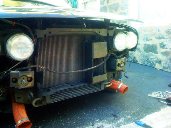

    When you hear your car drive by at full power, is it louder from the front or rear?
    At 4500 rpm in standstill (no load) your throttle bodies will be almost closed and also the amount of air going through the engine is small, and accordingly the power (where the noise finally comes from).
    If it is the induction noise, the snorcel of the airbox is like a trumpet...
    then you could try to blank off the path of the noise, i.e. make an additional box in front of the radiator.
    I enclose some pictures of the nice setup, which Uwe once made. It is basically a box with a foam filter in the rear, which draws the air behind the bumper. AFAIR, from his short test he reported a significant reduction of the induction noise without power loss.
    Thomas

    Thomas, thanks for the pics. The box that Uwe made in front of the snorkel seems interesting and worth of trying.

    Thanks! I think I will definitely try something like that, I'm only in need of dropping around 5dB, so maybe a "lighter" version of yours and Uwe's setup.

    First race weekend is behind and I managed to get the intake noise under the limit.
    Made up a box bit like Uwe and Mick from sound deadening material and that did the trick. I'm a happy camper
